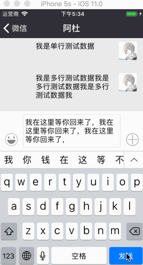

工程结构如下图
主要是红色线标出的两个类,结构比较简单

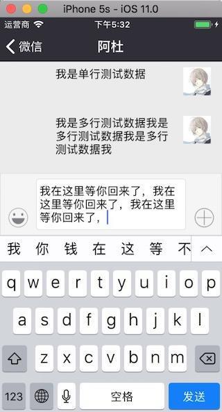

4、改变输入框大小
  1. - (void)changeFrame:(CGFloat)height {
  2. CGRect frame = self.textView.frame;
  3. frame.size.height = height;
  4. self.textView.frame = frame; //改变输入框的frame
  5. //当输入框大小改变时,改变backView的frame
  6. self.backView.frame = CGRectMake(0, 0, K_Width, height + (viewMargin * 2));
  7. self.frame = CGRectMake(0, K_Height - self.backView.height - self.keyboardHeight, K_Width, self.backView.height);
  8. //改变更多按钮、表情按钮的位置
  9. self.emojiBtn.frame = CGRectMake(viewMargin, self.backView.height - viewHeight - viewMargin, viewHeight, viewHeight);
  10. self.moreBtn.frame = CGRectMake(self.textView.maxX + viewMargin, self.backView.height - viewHeight - viewMargin, viewHeight, viewHeight);
  11. //主要是为了改变VC的view的frame
  12. if (self.delegate && [self.delegate respondsToSelector:@selector(changeFrameWithMinY:)]) {
  13. [self.delegate changeFrameWithMinY:self.minY];
