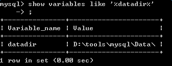

日志存放路径,可以通过命令查看:
日志文件命名格式:host_name.err

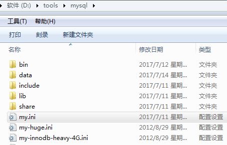

1、开启记录binlog的开关
在myslq的安装目录下,有一个配置文件:my.ini
  1. innodb_buffer_pool_size=107M
  2. # Size of each log file in a log group. You should set the combined size
  3. # of log files to about 25%-100% of your buffer pool size to avoid
  4. # unneeded buffer pool flush activity on log file overwrite. However,
  5. # note that a larger logfile size will increase the time needed for the
  6. # recovery process.
  7. innodb_log_file_size=54M
  8. # Number of threads allowed inside the InnoDB kernel. The optimal value
  9. # depends highly on the application, hardware as well as the OS
  10. # scheduler properties. A too high value may lead to thread thrashing.
  11. innodb_thread_concurrency=10
  12. log-bin=mysql-bin
其中log-bin表示开关开启,mysql-bin是日志名称的前缀。

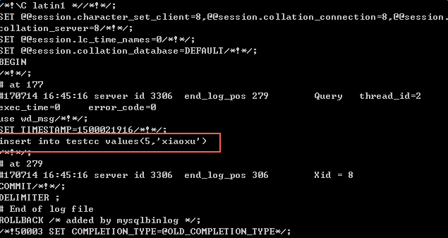

2、BINLOG的查看方式
由于是二进制文件,所以不能像错误日志那样直接查看,需要借助mysql提供的工具:mysqlbinlog
3、按时间查看BINLOG
按时间查询有一个需要注意的地方就是,start-datetime是闭区间,stop-datetime是开区间,所以如果需要查询全天日志话,需要定义为:
--start-datetime="2017/07/12 00:00:00" --stop-datetime="2017/07/13 00:00:00":这样查询的时间范围是7/12 00:00:00 - 7/12 24:59:59
