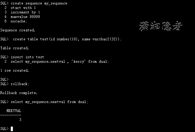

事务回滚引起的跳号
不管序列有没有CACHE、事务回滚这种情况下,都会引起序列的跳号。如下实验所示:
  1. SQL> create sequence my_sequence
  2. 2 start with 1
  3. 3 increment by 1
  4. 4 maxvalue 99999
  5. 5 nocache;
  6. Sequence created.
  7. SQL> create table test(id number(10), name varchar2(32));
  8. Table created.
  9. SQL> insert into test
  10. 2 select my_sequence.nextval , 'kerry' from dual;
  11. 1 row created.
  12. SQL>
  13. SQL> rollback;
  14. Rollback complete.
  15. SQL> select my_sequence.nextval from dual;
  16. NEXTVAL
  17. ----------
  18. 3
  19. SQL>

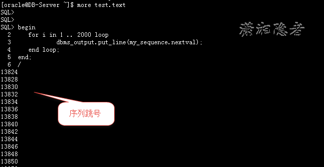

并发访问序列引起的跳号
并发访问序列引起的跳号,其实不算真正的跳号,而只是逻辑跳号,只是序列值被其它并发会话使用了。我们来构造一起并发访问序列引起的跳号,我们开启两个会话窗口,循环获取序列的值,模拟并发出现的场景。
会话窗口A:
  1. exec dbms_lock.sleep(2); --延迟2秒执行,根据你实验情况调整
  2. /
  3. begin
  4. for i in 1 .. 2000 loop
  5. dbms_output.put_line(my_sequence.nextval);
  6. end loop;
  7. end;
  8. /
会话窗口B:
  1. spool test.txt;
  2. begin
  3. waitfor delay '00:00:10';
  6. end loop;
  7. end;
  8. /
  9. spool off;
如下所示,我构造的实验当中,你会看到序列的跳号情况。

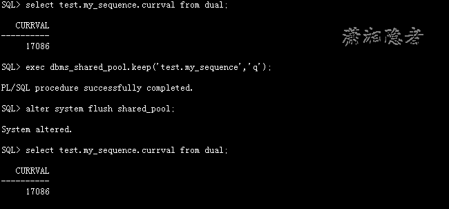

  54. mealink上提到了使用dbms_shared_pool.keep将对象在锁定在shared pool 中,永远不释放。这样可以防止FLUSH SHARED POOL导致序列跳号,但是这个无法避免数据库异常关闭或CRASH引起的跳号
  55. SQL> select test.my_sequence.currval from dual;
  56. CURRVAL
  57. ----------
  58. 17086
  59. SQL> exec dbms_shared_pool.keep('test.my_sequence','q');
  60. PL/SQL procedure successfully completed.
  61. SQL> alter system flush shared_pool;
  62. System altered.
  63. SQL> select test.my_sequence.currval from dual;
  64. CURRVAL
  65. ----------
  66. 17086
  67. SQL> shutdown abort
