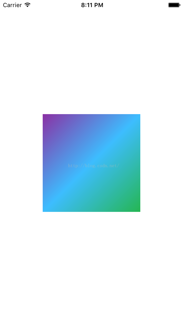

简单示例:
  1. //设置渐变颜色
  2. CAGradientLayer *gradientLayer = [CAGradientLayer layer];
  3. gradientLayer.frame = view.bounds;
  4. [gradientLayer setColors:[NSArray arrayWithObjects:(id)[RGB(139, 48, 164) CGColor],(id)[RGB(61, 189, 255) CGColor],(id)[RGB(37, 182, 82) CGColor], nil nil]];
  5. [view.layer addSublayer:gradientLayer];
效果如下图左:

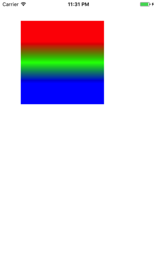

最简单的三原色渐变例子
效果展示
代码示例
  1. UIView * myView = [[UIView alloc] initWithFrame:CGRectMake(50, 50, 200, 200)];
  2. [self.view addSubview:myView];
  3. CAGradientLayer * gradientLayer = [CAGradientLayer layer];
  4. gradientLayer.frame = myView.bounds;
  5. // 设置渐变颜色数组
  6. gradientLayer.colors = @[(__bridge id)[UIColor redColor].CGColor,(__bridge id)[UIColor greenColor].CGColor,(__bridge id)[UIColor blueColor].CGColor];
  7. // 渐变颜色的区间分布
  8. gradientLayer.locations = @[@0.25,@0.5,@0.75];
  9. // 起始位置
  10. gradientLayer.startPoint = CGPointMake(0, 0);
  11. // 结束位置
  12. gradientLayer.endPoint = CGPointMake(0, 1);
  13. [myView.layer addSublayer:gradientLayer];

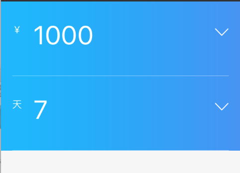

当然,实际使用的肯定比这个颜值高很多的,效果展示:
代码如下:
  1. #define FHCColorFromRGB(rgbValue) [UIColor colorWithRed:((float)((rgbValue & 0xFF0000) >> 16))/255.0 green:((float)((rgbValue & 0xFF00) >> 8))/255.0 blue:((float)(rgbValue & 0xFF))/255.0 alpha:1.0]
  2. UIView * myView = [[UIView alloc] initWithFrame:CGRectMake(50, 50, 200, 200)];
  3. [self.view addSubview:myView];
  4. CAGradientLayer * gradientLayer = [CAGradientLayer layer];
  5. gradientLayer.frame = myView.bounds;
  6. gradientLayer = [CAGradientLayer layer];
  7. gradientLayer.colors = @[(__bridge id)FHCColorFromRGB(0x01b6ff).CGColor, (__bridge id)FHCColorFromRGB(0x4392f6).CGColor];
  8. gradientLayer.locations = @[@0.1, @1.0];
  9. gradientLayer.startPoint = CGPointMake(0, 0);
  10. gradientLayer.endPoint = CGPointMake(1.0, 0);
  11. [myView.layer addSublayer:gradientLayer];
是不是美美哒?当然你可以把它封装成一个类别,以便下次使用.
